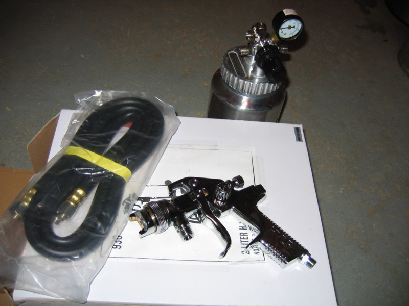

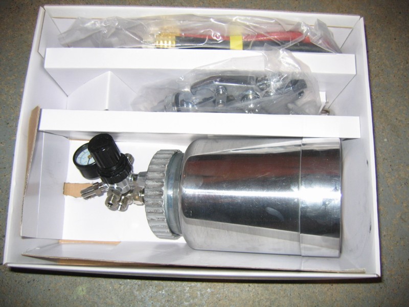

Alain,
A few months back I was at Mohawk in Vancouver buying some Nito and saw a 'pressure pot' HVLP gun behind the counter. It know lives at my house !! I has a 2 litre pot that connects to the spray head buy two hoses. I like the idea of not having the lacquer attached to the gun as I think it allows more freedom for spraying. I have not used it yet but even though it is an overseas product the finish of the tool is very nice and all of the fittings look very good quality. It cost $190 plus taxes. I am just working on building the studio that will include a full finishing area with my new buffer that I am building right now (got the shaft today ! Anyway, I think is a Mohawk around you somewhere. Josh House uses their products so I guess he would know where they are.
Just another option, let me know if I can get you more info. I have a big old 5hp two stage compressor to run the thing.

PostPosted: Thu Aug 17, 2006 6:30 pm
Hey Alain,
I was taking pics for Serge so I thought I should snap a couple of the gun I have. Again, I haven't used it but the Mohawk people said that they have gotten very good reports from those that have bought them, but I don't know what application they were using them for. They are selling the things though..... Maybe someone here will have something to say about it. It comes with a 1.5 mm nozzle.

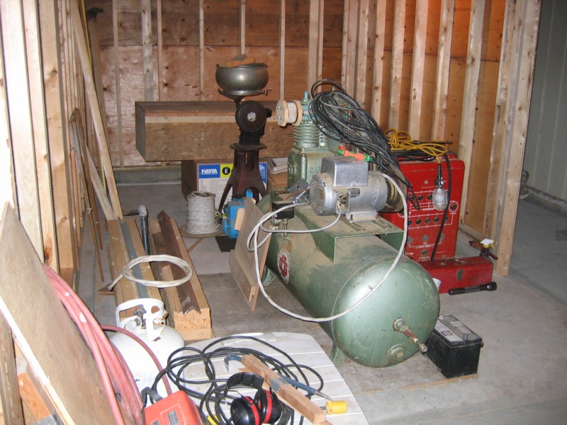

And this is the old beauty that will be supplying air for the shop and especially the spraying operations.

PostPosted: Fri Aug 18, 2006 1:11 am
i have compressor capacity envy!!!!!
PostPosted: Fri Aug 18, 2006 2:27 am
Wow Shane, that looks like a fantastic gun... Do you think that compressor can hold enough air?

Shane, do you use the cream separator to filter your lacquer <g>
